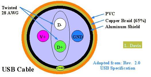

USB Cable colors:
Pin Name Cable color Description
1 VBUS Red +5 VDC
2 D- White Data -
3 D+ Green Data +
4 GND Black Ground
Voltage:
• Supplied voltage by a host or a powered hub ports is between 4.75 V and 5.25 V.
• Maximum voltage drop for bus-powered hubs is 0.35 V from it's host or hub to the hubs output port.
• All hubs and functions must be able to send configuration data at 4.4 V, but only low-power functions need to be working at this voltage.
• Normal operational voltage for functions is minimum 4.75 V

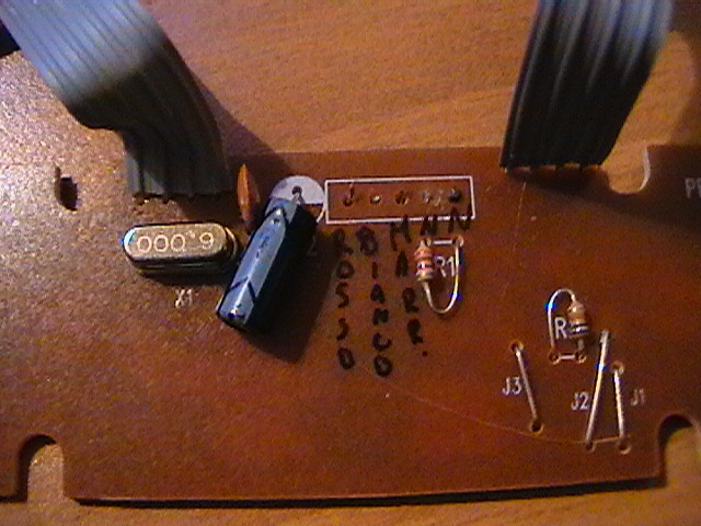

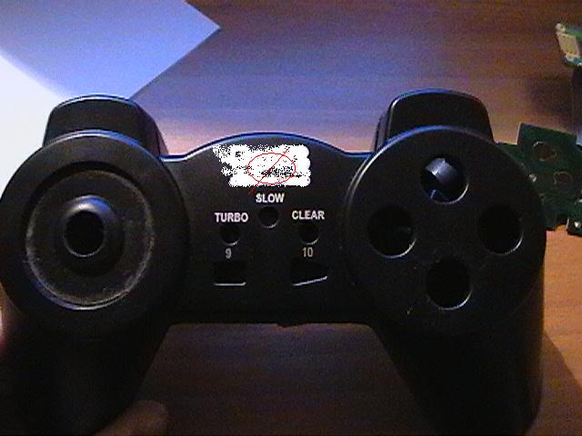

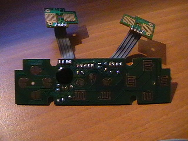

 ho provato a fare qualche collegamento ma il computer mi dice periferica non riconosciuta. VOI POTETE INVENTARVI QAULCHE COSA?[/img]
